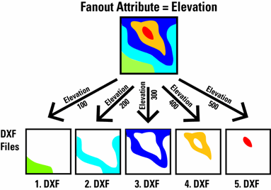

Dataset Fanout
A dataset fanout divides the data and writes a different dataset for each division. In this example, data is divided up into a number of datasets on the basis of an elevation attribute.
