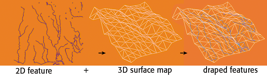

These input features may be 2D or 3D. If they are 3D, their z values will be overwritten. Features input through this port are output via the DrapedFeatures output port with their z values set to interpolated values on the underlying surface model.

This output port produces features input through the DrapeFeatures port, with their z values set to interpolated values on the underlying surface model.

This parameter controls whether input DrapeFeatures will retain its vertex count, or be modified to adhere to the underlying surface model:
Note: Note: In general, MODEL produces more detailed results than VERTEX, but may require significantly more processing time to generate draped features.
This parameter controls whether input DrapeFeatures with Z values will be offset or have Z values replaced:
