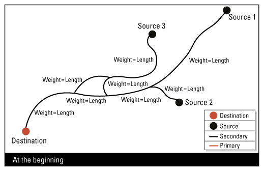

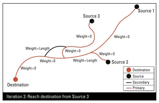

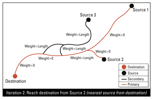

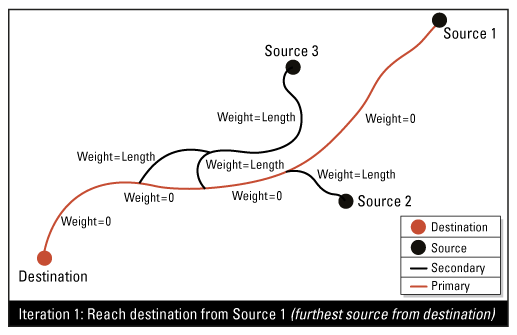

Calculates the primary and secondary streams of multiple stream networks. The key to determining the priority is the shortest path algorithm using multiple iterations within a network graph.
This attribute defines, for each source junction of the network, a unique path (the shortest path) to reach the destination junction. All flow lines included in a path (from the sources to the destination) will have a stream priority attribute set to 1 (primary); all others are set to 2 (secondary).

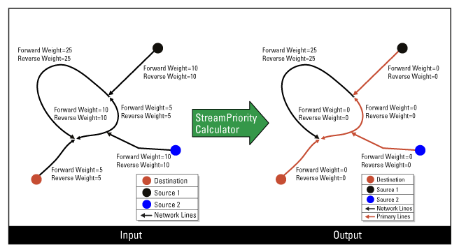

This transformer can be used on network linear flow lines. There are two ways to determine the stream priority attribute:

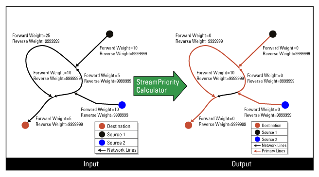

When the network lines are oriented, the shortest path should not go against the digitized direction. So initially the weight along the digitized direction (the forward weight) is the length, and the weight against the digitized direction (reverse weight) is a bigger value.
Note that the reverse weight is optional, and usually not required.
