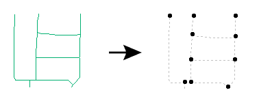

Computes intersections between all input features, breaking lines and polygons wherever an intersection occurs. In addition, all overlapping segments are reduced to one segment before being output.
The intersected features are output to this port. If the List Name parameter was specified, these features will have an attribute containing their number of overlapping input features. They will also have all attributes of the original features. If the input is an aggregate with one valid geometry part and one invalid geometry part, the geometry will be deaggregated. The valid part will output through the Intersected port, and the invalid part will output through the <Rejected> port.
The locations of topologically significant nodes are represented by point features and are output to this port. The transformer parameters modify which attributes are included on the output features.

When a coverage of polygons is input, the set of topologically significant lines which form their boundaries is output.
