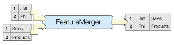

Copies and merges the attributes/geometry from one feature (or multiple features) onto another feature (or multiple features). Features that contain the desired attributes/geometry are connected through the Supplier port, and the features that will receive the attributes/geometry are connected through the Requestor port.
When a Requestor finds a Supplier, the attributes from the Supplier are merged with the Requestor. If the Requestor already had an attribute that the Supplier also had, the Requestor's original value for that attribute can be preserved or overridden, depending on parameter settings. A single Supplier may be used by many Requestors. Many Suppliers can be merged onto a single Requestor.
Any merged geometry preserves arcs, ellipses and text.
When attribute names conflict, you can choose whether Requestor or Supplier attribute values are maintained by using the Conflict Resolution parameter, and whether null values follow the same behavior by using the Ignore Nulls parameter.
