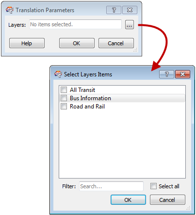

To run the workspace, select Run > Run With Prompt, press Ctrl+R, or click the button.
Prompt and Run will display a Translation Parameters dialog. The translation will pause until you choose which layers to group.

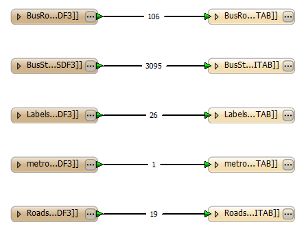

If you Select All, the features are set to all feature types:
If you select Bus Information only, for example, the feature types are set to Bus Routes and BusStops only:
