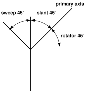

Arc attributes
- fme_geometry = fme_point
- fme_type = fme_arc
- fme_rotation: The rotation of the primary axis in degrees counterclockwise from the primary axis. If not set, then 0 is assumed.
- fme_primary_axis: The length of the primary semi-axis (radius) of the defining ellipse measured in ground units.
- fme_secondary_axis: The length of the secondary semi-axis (radius) of the defining ellipse measured in ground units. For circular arcs this value is equal to the fme_primary_axis. This attribute is optional. If not present, it is assumed to be a circular arc with the same value as fme_primary_axis.
- fme_start_angle: Refer to Arcs (IFMEArc) for a detailed definition of
start_angle.
- fme_sweep_angle: Refer to Arcs (IFMEArc) for a detailed definition of
sweep_angle.
