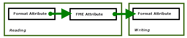

A particular set of Format Attributes has the prefix fme_. These attributes represent the data as it is perceived by FME. They are sometimes known as FME Attributes or Generic FME Attributes.

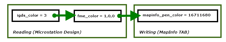

During a translation, the following occurs:
FME reads the source data and stores information about its features as format attributes. These format attributes reflect the data that is stored in the original Reader Format.
FME converts the source data’s format attributes into FME Attributes. These FME attributes reflect the source data as the FME internal format would store it.
FME writes the destination data by creating a new set of format attributes. These format attributes reflect the destination data as it will be stored in the Writer Format.
FME converts from one format to another without having to separately map the source data's format attributes directly to the destination format's attributes for every format. FME converts everything to an FME standard, and then converts it again to the writer format.
