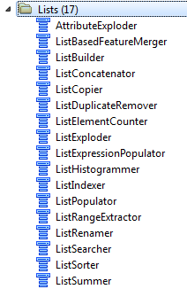

There are many transformers that you can use to manipulate lists: see the Lists category in FME Workbench transformer gallery.
