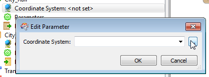

Each Coordinate System parameter is linked to FME's Coordinate System Gallery. Double-click the parameter to display a list of recently used coordinate systems, or the browse button to access FME's Coordinate System Gallery.
