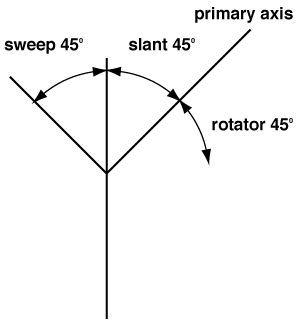

fme_arc
fme_point
fme_rotation: The rotation of the primary axis in degrees counterclockwise from the primary axis. If not set, then 0 is assumed.
fme_primary_axis: The length of the primary semi-axis of the defining ellipse measured in ground units.
fme_secondary_axis: The length of the secondary semi-axis of the defining ellipse measured in ground units. For circular arcs this value will be equal to the fme_primary_axis.
fme_start_angle:
Refer to the @Arc (function) in the FME Functions and Factories manualfor a detailed definition of start_angle.
fme_sweep_angle:
Refer to the @Arc (function) in the FME Functions and Factories manual for a detailed definition of sweep_angle.
