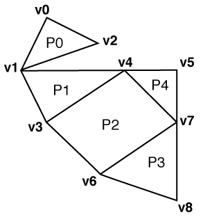

IFMEMesh
A mesh is a special collection of simple single-sided facets or parts. These parts need not have any spatial or topological relationship between each other.
A mesh is referenced geometry containing a common vertex pool, vertex normal pool, and texture coordinate pool. The individual parts of the mesh represent single sided faces with planar polygon structure. The orientation of each mesh part is determined using the same rule as for faces. The parts of a mesh are defined by indices into the common pool. By allowing reuse of shared vertices, the physical representation size of a mesh can be smaller than an equivalent collection of surfaces.

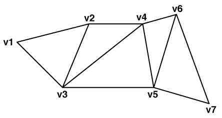

IFMETriangleStrip
A triangle strip is a series of connected triangular faces. These faces are defined by three consecutive points in a point list. The first three vertices (denoted below by v1, v2, and v3), define the first triangular face. A new triangle is formed by connecting the next point with its two immediate predecessors. That is, every additional point vi defines a new triangular face with vertices vi–2, vi–1, and vi.
For example, the second triangle is defined by v2, v3, v4, the third by v3, v4, v5, etc. The following diagram illustrates a typical IFMETriangleStrip.
The orientation of the entire triangle strip is determined by the orientation of the first triangle. If the vertices of the first triangle are ordered counterclockwise then the front of the strip is displayed; otherwise the back is displayed. If the triangle strip has been flipped, then the front/back of the entire strip is actually the reverse of what the first triangle indicates.
