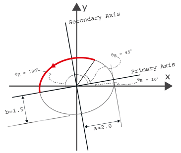

Arc |
Creates an arc using the specified parameters. The primary axis parameter specifies the length of the primary axis, and the secondary axis parameter specifies the length of the secondary axis. The start angle parameter specifies the start angle for the arc, measured in degrees counterclockwise from horizontal. The sweep angle parameter specifies the number of degrees on the ellipse that define the arc, measured in degrees counterclockwise. The rotation parameter specifies the angle in degrees from the horizontal axis to the primary axis in a counterclockwise direction. A circle can be created by setting the primary and secondary axis to the same length and using a sweep angle of 360 degrees.

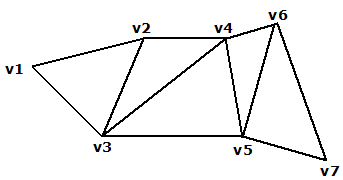

Triangle Strip |
Creates a triangle strip, which is a series of connected triangular faces. These faces are defined by three consecutive points in a point list. The first three vertices (labelled below as v1, v2, and v3), define the first triangular face. A new triangle is formed by connecting the next point with its two immediate predecessors. That is, every additional point vi defines a new triangular face with vertices vi–2, vi–1, and vi. For example, the second triangle is defined by v2, v3, v4, the third by v3, v4, v5, etc. The following diagram illustrates a typical Triangle Strip.

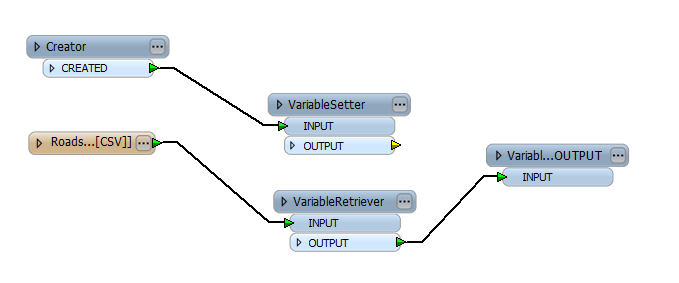

The workspace shown here is trying to combine two paths of features through the VariableSetter and VariableRetriever. The problem is that FME's data flow was not designed to consider multiple feature paths and so, no matter what the setting is for the Create at End parameter, the Creator always creates its feature after the reader.

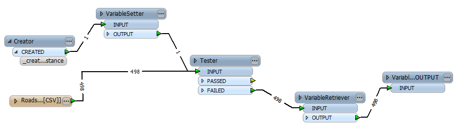

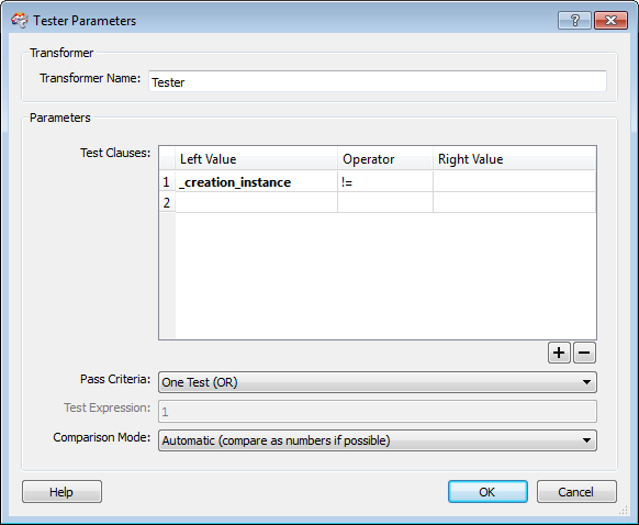

A Tester is added to both the Creator data flow and the reader data flow:
In the modified workspace shown below, the feature from the Creator data flow will be discarded through the Tester's FAILED port and features from the reader data flow will continue – however, the features will now be processed either before or after the Creator, depending on the chosen setting in the Create at End parameter.
