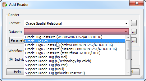

You can add a named database connection, or use an existing one, at the time you want to use one in an Add Reader, Add Writer, or Transformer Parameters dialog.
For example, when adding an Oracle Spatial Relation reader, in the drop-down menu of the Dataset field, select Add Named Database Connection.
In the Add Database Named Connection dialog, specify the connection parameters, and the give the connection a name (or accept the default), and click Save.
Alternatively, if you do not want to use a named connection, in the drop-down menu of the Dataset field, select Exposed Connection Parameters. Then, click Parameters and specify the connection parameters in the parameters dialog.
The next time you need to use the newly-created named connection in a workspace, it will be listed in the drop-down menu of the Dataset field, along with any others you have created that apply to the format or service.
