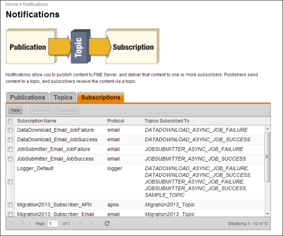

Subscriptions determine how notifications on topics are delivered. Click on the Subscriptions tab to open the table view of subscriptions. You will see a list of subscriptions each associated with a set of topics as noted by the "Topics Subscribed To" column.
To create a subscription and associate it with topics, click on the New button.

To modify an existing subscription, click on the subscription entry in the table. A dialog similar to the one used to add new subscriptions will appear populated with the properties of the selected subscriptions. Make changes as needed and click OK.
To remove an existing subscription select the subscription row from the table and click Remove.
