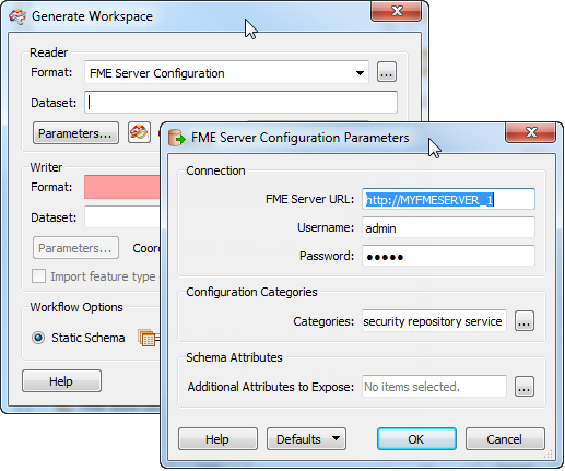

To migrate your 2013 FME Server configuration to another FME Server 2013 instance:
The Generate Workspace dialog opens.

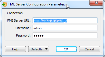

Click the Writer Parameters button to open the Repository Parameters dialog.
Specify the information required to connect to your running FME Server, and then click OK.
