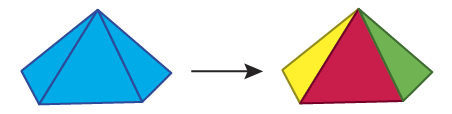

Each output feature may keep a complete, unaltered copy of the source feature's attributes.
All deaggregated features, as well as features that could not be deaggregated, will be output via this port.
Flatten One Level: this option will break an aggregate feature into child parts one level deep then output each child part as a feature. That is, nested geometries will be deaggregated at the top level.
Flatten All Levels: this option will break a nested aggregate into child parts at all levels then output each leaf (a part that has no children) as a feature. That is, nested geometries will be deaggregated recursively and only leaf nodes are output.
Preserve Hierarchy: this option will break a nested aggregate into child parts at all levels then output each part as a feature. That is, nested geometries will be deaggregated recursively and all child parts are output. ID information is added to each output feature to preserve the input hierarchy information.
