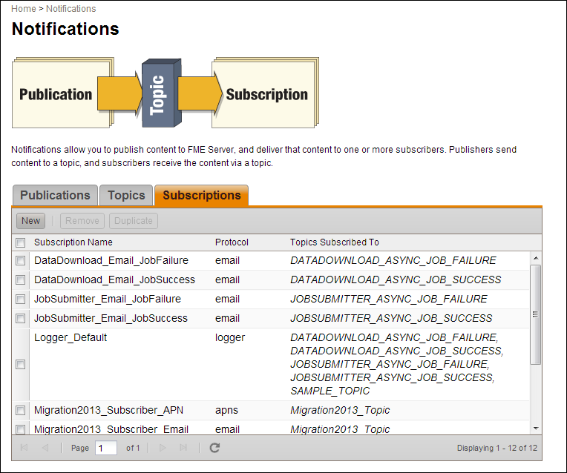

Subscriptions
Subscriptions determine how notifications on topics are delivered. Click on the Subscriptions tab to open the table view of subscriptions. You will see a list of subscriptions each associated with a set of topics as noted by the "Topics Subscribed To" column.
Creating a Subscription
To create a subscription and associate it with topics, click on the New button.
- Provide a name for the subscription.
- Assign relevant topics to this subscription for which notifications will be delivered. Use the item-selector box in the Assigned Topics section to move topics from the left-window into the right-window. Click on Add All >> to assign all topics to the subscription or click on select topics and click on Add > to assign specific topics to the subscription.
- Select a protocol. (See below for descriptions)
- Protocol-specific fields will appear in the Parameters section. Complete these fields.
- Click OK.
