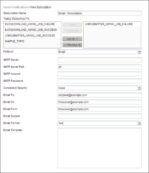

Subscriber
An email subscriber is a configuration required to deliver email messages. The configuration contains information on the email server (SMTP) connection, authentication, default email subject, recipients, email body template and so on. A complete list of email subscriber properties follows:
The following dialog allows the FME Server administrator to configure the email subscription using the Web User Interface.
If email_subject and email_to keywords are specified in the notification, they will override the default email subject and recipients configured in subscriber respectively.
