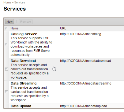

To enable SSL for a service, open the FME Server Web User Interface, click Services, and click the desired service in the table.

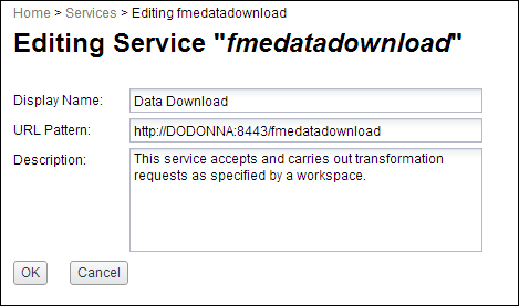

The Editing Service page opens.
In the URL field, change HTTP to HTTPS, and modify the port number, if required. Typically SSL is configured on either port 8443 or 443.

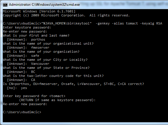

For any HTTPS (SSL) page, a certificate is required. First, you must generate a keystore that contains a certificate chain using the keytool command from the Java Developer Kit (JDK).
To set up SSL for Apache Tomcat 7 using self-signed certificates, follow these steps:
  1. Open the command prompt.
  2. Type the following command:
    keytool -genkey -alias tomcat -keyalg RSA
    If your path is not set to the Java bin directory, navigate to that directory and type the appropriate command.
    Note:  A JDK must be installed to use the keytool command.
    A message prompts you to enter a keystore password.
  3. Enter changeit.
    You can give the keystore password a different name; however, if you do, you must make some changes later.
  4. Enter the required details, shown here:
    A message prompts you to enter the alias password, which must be the same as the keystore password.
  5. Enter the same password you entered in step 3.
    A keystore is generated in the following location:
    <drive>:\Users\<username>\.keystore
    where <drive> is C: and <username> is hnguyen.
