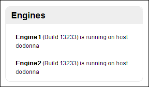

Confirm that the FME Engines are licensed:
Log in to the Web User Interface with the username and password you entered during installation.
The home page lists the licensed and running FME Engines.
If there are no FME Engines, your FME Server might not be licensed. Confirm that you have an FME Engine floating license available. See Licensingfor instructions on acquiring a license.
If you confirm that you have a floating license available, reconfigure the license server that FME Engines are using, and restart FME Server. See Licensing and Starting and Stopping FME Server.

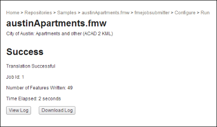

Confirm that FME Server can run a job:
After you confirm that your FME Engines are licensed, confirm that FME Server can perform its primary function—running a job.
  1. Open the Web User Interface in a web browser by going to:
    http://<host>/fmeserver
    Note:   If you are using a non-standard port, enter the port number after the host name, for example:
    http://localhost:8080/fmeserver
  2. Log in with the administrator account that you created during install.
  3. Click Repositories > Samples > austinApartments.fmw. Under Job Submitter, click Run.
    If you see a success message, your install was a success.
