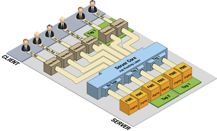

Job Routing is a mechanism for sending specific jobs to specific FME Engines. The reasons for doing this include:
Job routing uses tags to assign jobs to a subset of available FME Engines. With tags, you can associate specific jobs with certain engines, or associate all jobs in a repository with certain engines.

In this example, any job with the tags "fast" or "normal" are processed (accepted) by engine1 or engine2, while engine3 processes jobs with the "utility" tag. Any jobs with any other tag or no tag are processed by any other engines that have not been assigned a tag or have been assigned the "default" tag. (By default, these engines are associated with the tag assigned to TM_DEFAULT_TAG.)
