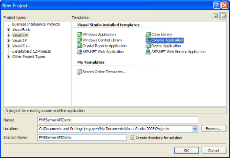

  2. Choose File > New Project.
  3. In this example, we'll create a Visual C# project with the Console Application template and name it FMEServerAPIDemo.

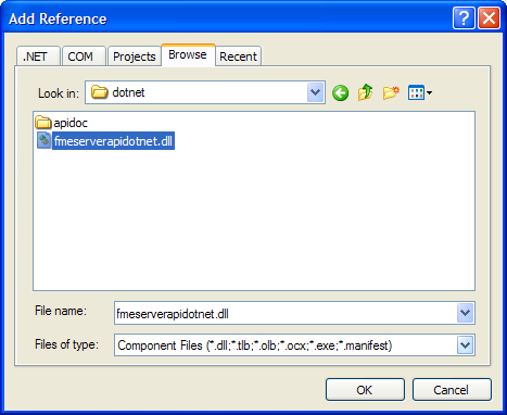

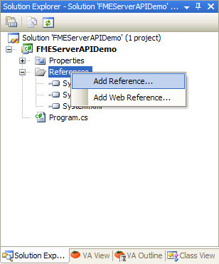

  4. On the References folder in the Solution Explorer, click on Add Reference … to add a reference to the FME Server .NET API.
  5. The file name for the FME Server .NET API assembly is fmeserverdotnetapi.dll and is located at <FMEServerDir>\Server\sdk\dotnet\fmeserverapidotnet.dll. Browse to the location of the fmeserverapidotnet.dll and select it.
