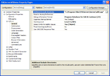

  5. Choose Project > Properties to open up the Properties dialog for the project. Under C/C++ > General > Additional Include Directories, add the path to the <FMEServerDir>\Server\sdk\cpp folder.
  6. Also include a directory for the FME Objects directory containing the header files (depending on where you installed FME Objects).

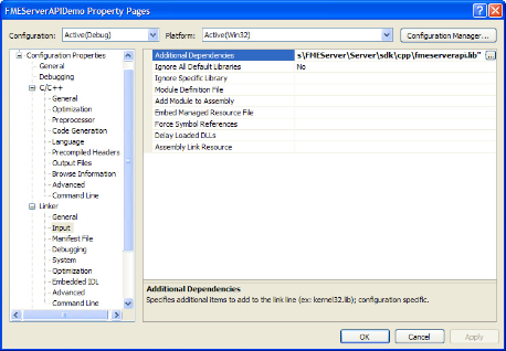

  9. Under Linker > Input > Additional Dependencies, add the path to the <FMEServerDir>\Server\sdk\cpp\fmeserverapi.lib file.

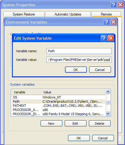

  11. Since our sample application is in a different folder from the FME Server C++ API folder, add the <FMEServerDir>\Server\sdk\cpp to the Path Environment Variable. You may need to restart Visual Studio or your computer for the new Path settings to take effect.
  12. Note:  An easier approach is to just copy the contents of the FME Server C++ API folder into the directory of your application. By doing that you can avoid setting the Path Environment Variable.
