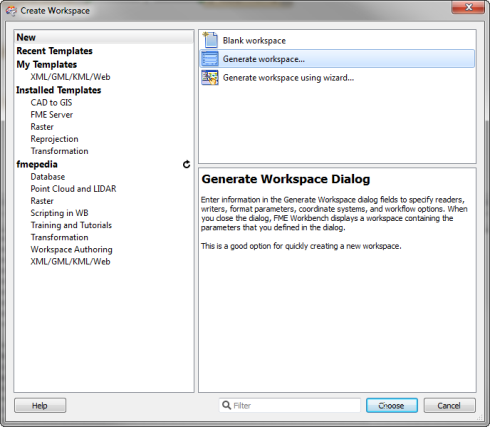

  2. Select File > New.
  3. Select Generate workspace.
    The Create Workspace dialog opens.

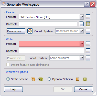

  4. Click Choose to open the Generate Workspace dialog.
  5. Select FME Feature Store (FFS) as your Reader Format.

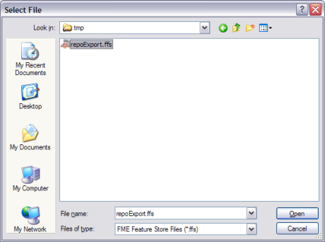

  6. Click to open the Select File dialog.
  7. Select the FME Feature Store (FFS) files containing the FME Server repositories that you want to import, and then click Open.

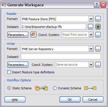

  8. In the Generate Workspace dialog, select FME Server Repository as the Writer Format.

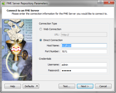

  9. Click the Writer Parameters button to open the Repository Parameters dialog.
  10. Specify the information required to connect to your running FME Server, and then click Next.

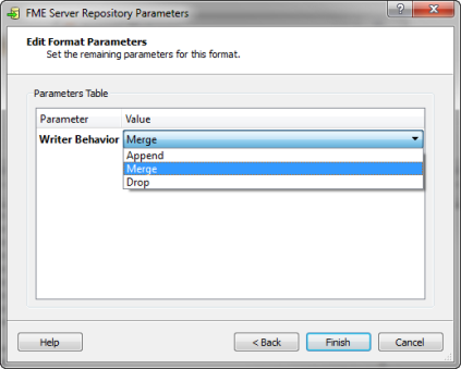

  11. Specify the action to be taken when a repository, item, or resource already exists:
  12. Click Finish.

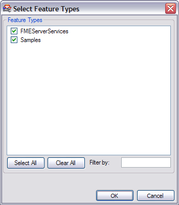

    This causes the Select Feature Types dialog to open. Each feature type represents an FME Server repository (except for the one named FMEServerServices, which contains metadata related to FME Server services).
  14. Select the feature types (repositories) that you want to import, and then click OK.
    When the workspace is created, you can still remove repositories that you do not need to import. Select them in the workspace, and press the Delete button.
