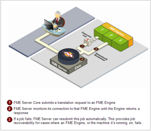

Job recovery ensures that submitted jobs are not dropped completely, if the connection to the FME Engine is lost for any reason.
After FME Server submits a translation request to an FME Engine, it monitors the connection to that engine until a response is returned. If the connection to the engine is lost, FME Server can resubmit the job.
The default configuration is to retry a failed job three times only, which prevents FME Server from indefinitely retrying a job that fails.
