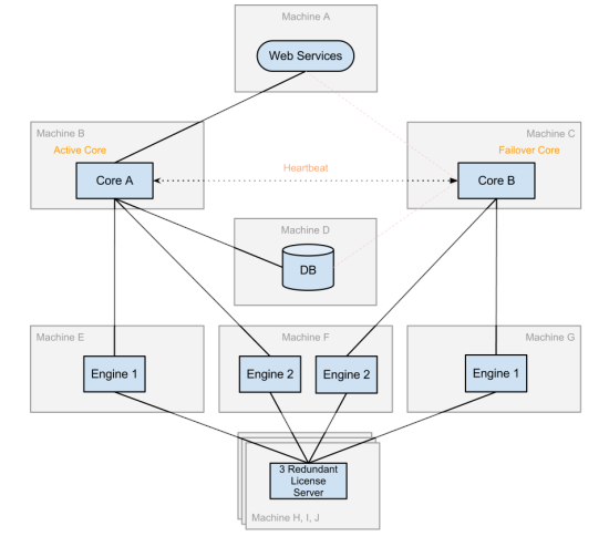

Failover Architecture
The following diagram shows the basic structure of FME Server failover.
Note:  To limit hardware costs, two instances of Engine 1 can be on the same machine, with one instance connected to the Primary host and the other to the Failover host. See Configuring FME Engines for Failover below.
When the Core A machine fails, clients connecting to Core A failover to Core B. Because the Failover Core is now the “active” Core of the cluster, clients subsequently always connect to the Failover Core so that processing continues. When a heartbeat failure is detected, this Faillover Core takes over Jobs and Schedules.
When the Core A machine and associated Engines are restored, Core B remains the Active Core, while Core A is now online as the Failover Core.
Note:  Notification Service publishers (including UDP, Email and JMS clients) do not failover. These clients must be manually reconfigured to connect to the active core.

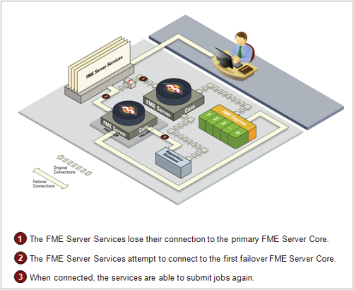

Configuring FME Server Services for Failover
You can configure individual FME Server services to switch to a backup FME Server Core when the connection to the primary FME Server Core is lost. This capability is called "service failover".
When a service loses its connection to the primary FME Server Core, the service attempts to connect to a backup FME Server Core you define. In a fault tolerant cluster, a primary FME Server Core can only have one backup FME Server Core.
  1. Open each web application properties file located at:
    <WebAppDir>\<fmeServiceName>\WEB-INF\conf\propertiesFile.properties
  2. Find the following line in this file:
    #FAILOVER_SERVER_NAMES=<failoverServerName>
  3. Uncomment this line and replace <failoverServerName> with a host name.
    The host name must be running an FME Server, for example:
    FAILOVER_SERVER_NAMES=red
    This example defines an FME Server system—red—which must be running an FME Server.
  4. Restart the web application server.

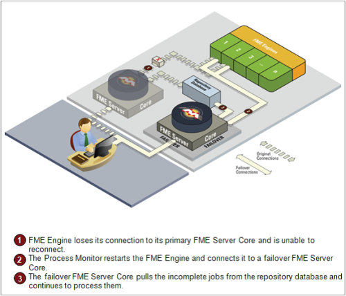

We recommend configuring redundant FME Engines for both the primary FME Server Core and the secondary FME Server Core. If you wish to limit the number of machines used, you can start up FME Engines with the same name on the same machine, with one engine connected to the primary FME Server Core and the other connected to the failover FME Server Core.
